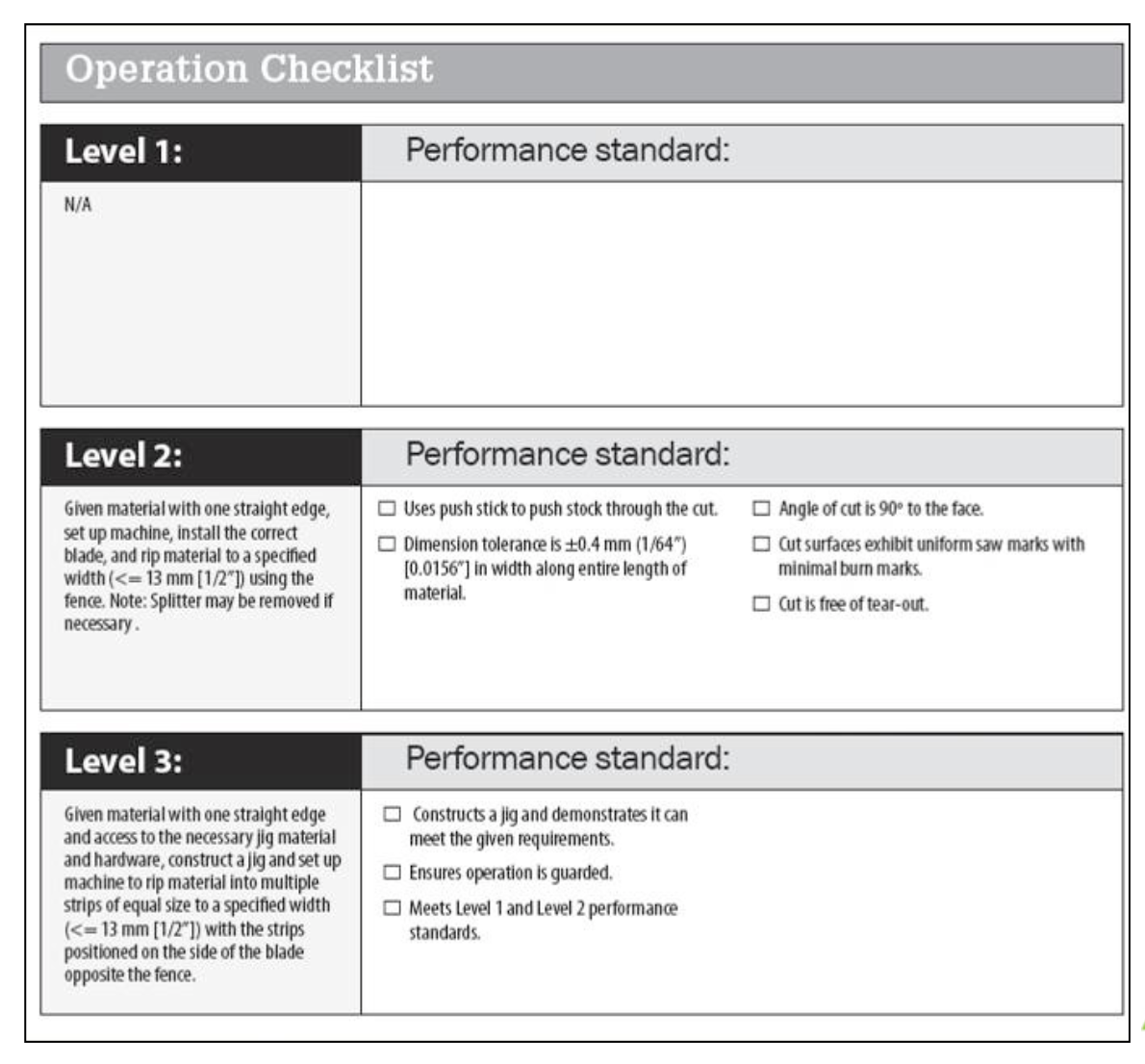

At right is an example of an assessment form for a tool operation, which represents the Skill Standard for the operation. Each Tool Operation has three parts:

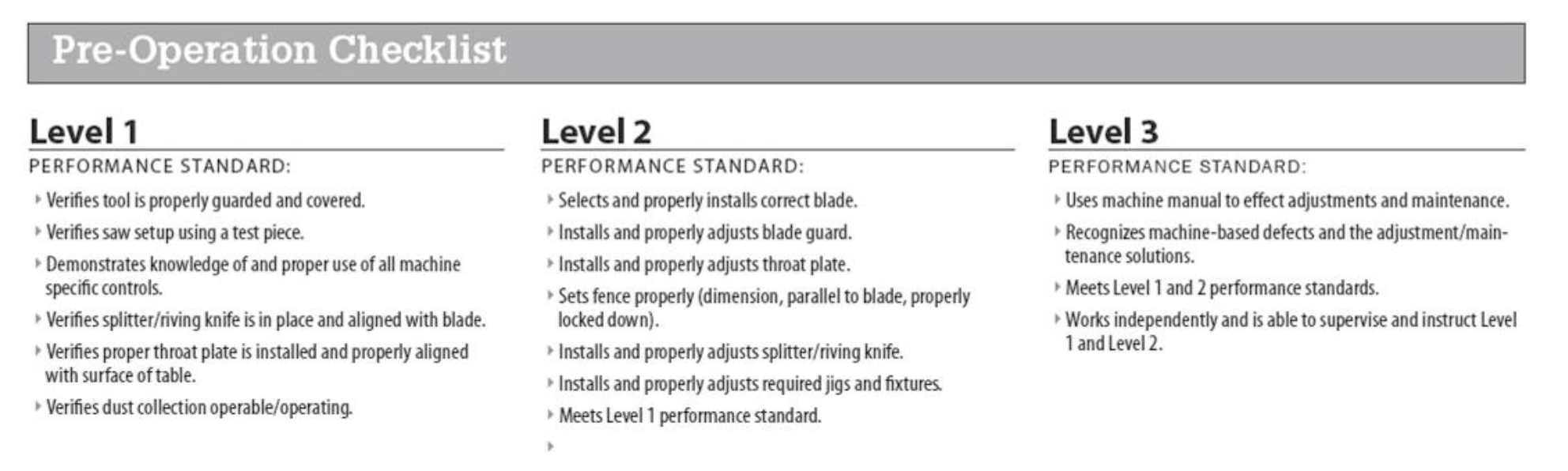

Pre-Operation Checklist – Assesses candidates knowledge of the tool’s controls.

Operation Checklist – The measurable result of an operation.
This section guides the evaluator in assessing the candidate’s knowledge of the machine and its controls and applies to all the operations for a particular tool. This section is a general guideline for the evaluator; a candidate might fail one or two items in this area, but not fail the assessment if it is the judgement of the evaluator that it was only a minor error in judgement that didn’t affect safety, such as forgetting to open the dust collector blast gate. However, if the candidate shows a general lack of knowledge of the tool, the evaluator may elect to fail them.

Operation Checklist
This section is the heart of the assessment and contains the observable, measurable output of the operation. For example, if the candidate is being assessed on Tablesaw->Ripping, the evaluator will judge the board that was ripped during the operation. The candidate must pass ALL line items in this section in order to pass the assessment.
Note that if a candidate is being assessed at Level 2, they are also being assessed on the Level 1 criteria as well as any additional Level 2 criteria. Each Level consists of a scenario for the operation. In the case of Level 1, the Evaluator sets the machine up for the Candidate. In Level 2, the scenario requires that the Candidate setup the machine prior to performing the operation.
